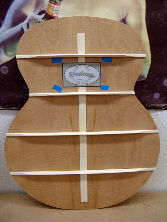

Ricardo I use finger planes mostly for these triangular shaped braces.  But it starts with a center line marker that I use to scribe the middle of the top of the brace.  My brace stock is planed just proud of the height that I want so that the center line scribed indentation can be planed away as the last step.  Sometimes it takes me a couple of tries to get the slight amount of flex that I want in a back so I start taller and work down.
Here is a shot of the finished back complete with plastic cover over the label.

Hesh, I would be interested in knowing the dimensions of your braces?

Sure James - all four braces are 1/4" wide at the base.  The two longest braces located on the lower bout are 7/16th" high in the center and taper toward the ends to match the 15' dome of the back.
The two upper bout braces are 1/2" high in the center and also slightly taper with the back's dome.
I wanted the lower bout braces less stiff by design so that I can have a slight amount of flex in the lower bout.  The upper bout I wanted stiffer where the neck joins the body.  Just remember this is my thinking on the objectives that I am trying to achieve and I am not sure what will result so YMMV.
